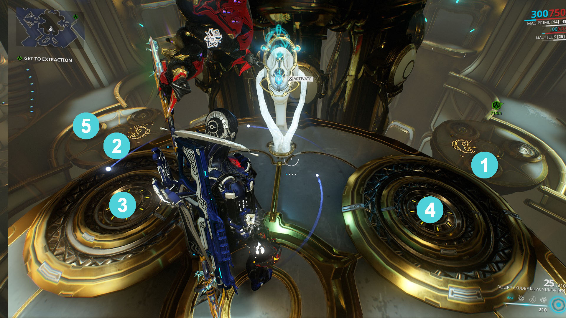

Bonus: Lua Music Puzzle
The Lua Music Puzzle randomly/rarely appears on Lua maps. It is not part of the seven principles but should be done nonetheless. It rewards the players with a Octavia Chassis blueprint uppon completion and also spawns a container left of the activation switch which has a chance to contain a crafted Forma.
The chance to get a Forma is enough reasons not to skip this room when you encounter it.
The task is easy.
Activate the switch and the music instrument will play 5 tones. You can see a blue glow on the pads which produce the tones. Just repeat the sequence of tones to finish the puzzle.
The sequence always is the same.
Right pad, front button
Left pad, front button
Upper pad, left button
Upper pad, right button
Left pad, left button
