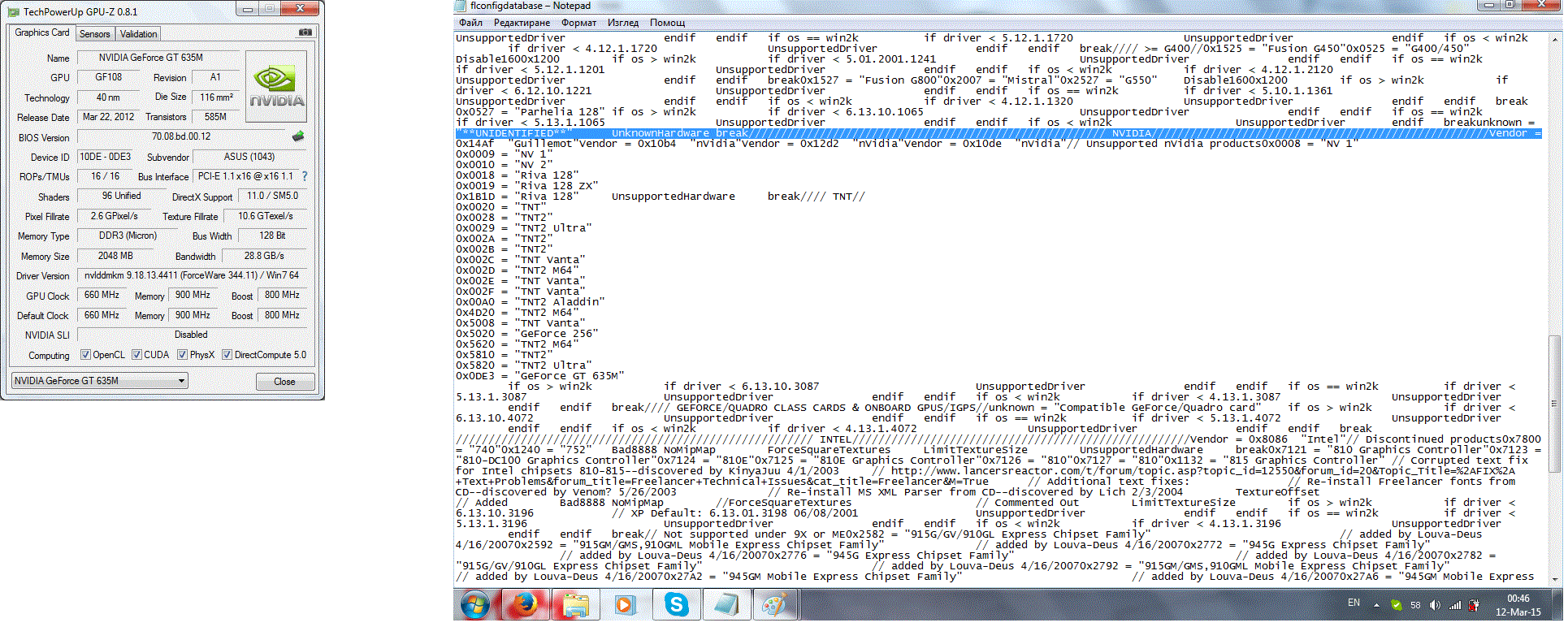

    Screen of the Flconfigdatabase.txt and GPU: 033356dc88080eab.gif
    P.S 2 - I've changed the name from GeForce GT 635 to Geforce GT 585
    p.S 3 Sorry its in Bulgarian, I hope you can Google translate it so you can resolve the issue I'm having.
