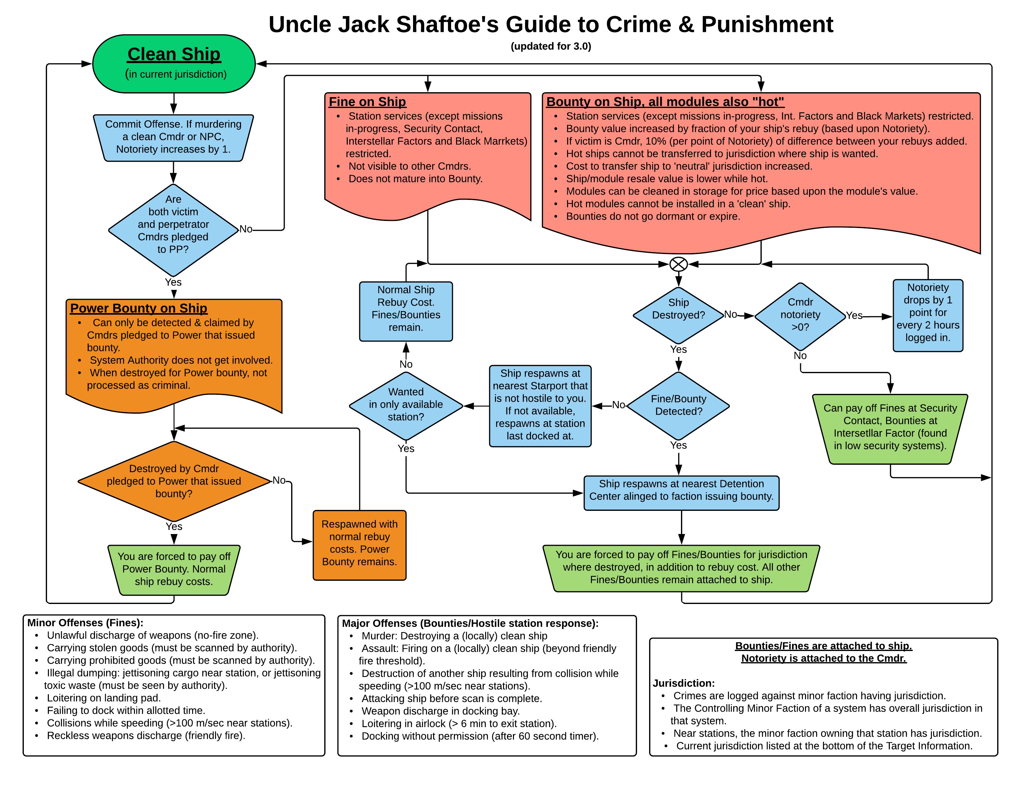

Info below is little outdated, but still well enough usable for "ships" play. Especially infographic made by Cmdr Jack Shaftoe is a good one (source was reddit post which is no longer available).
Few notes:
- To stay out of troubles: do not kill "non-wanted" ships except if in Anarchy systems (there you can shot all anytime without any consequence)
- ATR ships give timed warning before arrival. They are equipped with lasers which can destruct shield generator THROUGH shield. Unless you are prepared for this (i.e. you do crimes purposely and you know & can fight shieldless), you really do not want wait for ATR ship(s) arrival ...

Info-Graphic:
